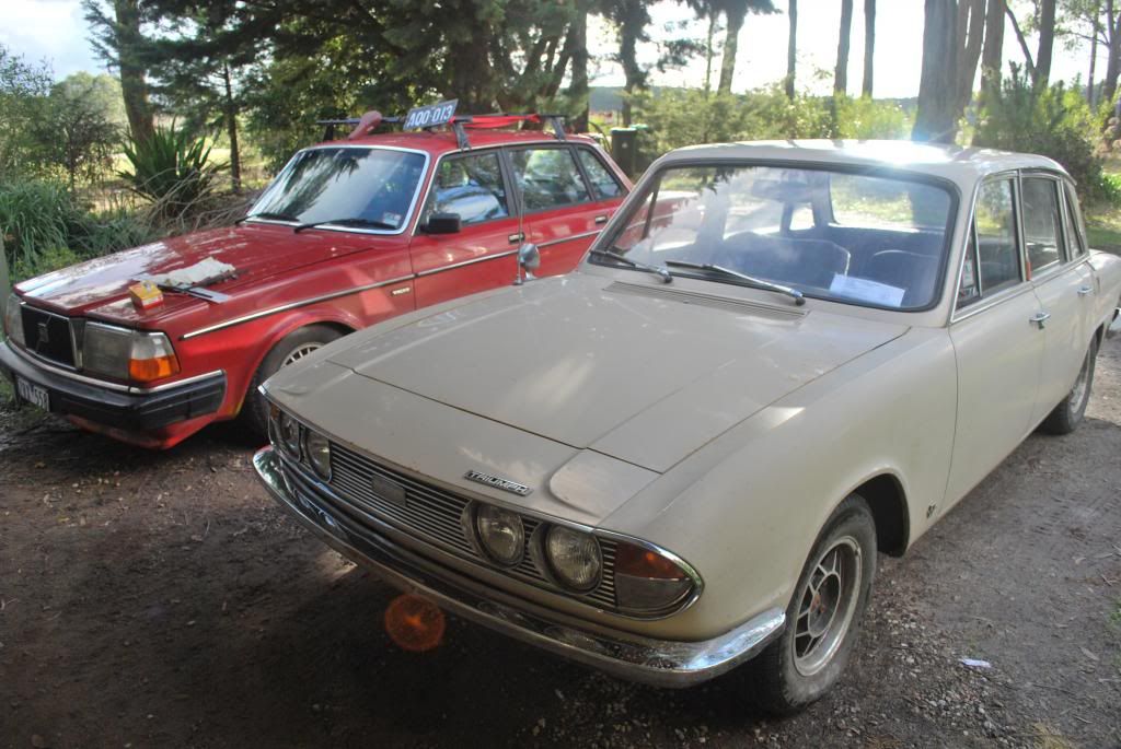

yes yes, another old car. bit different this one though, its already roadworthy.
i'd love to say its sat in the driveway, but it only made it 1km to a mates place, due to a dead battery that "has been fully charged and holds voltage...."

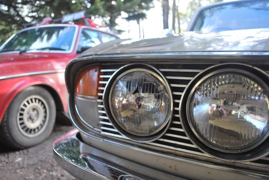

next up, headlight:
closer look:

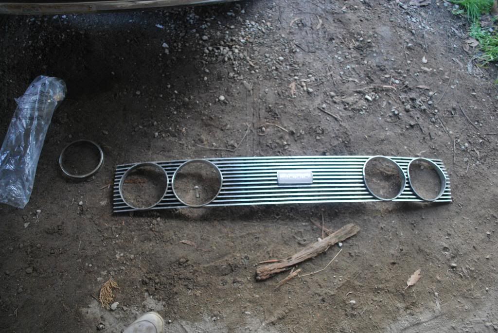

grille off and chrome surround:

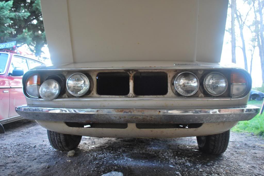

new light in:
old one out:

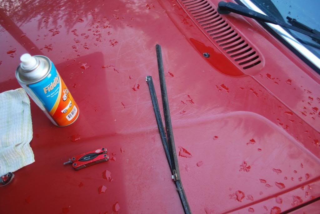

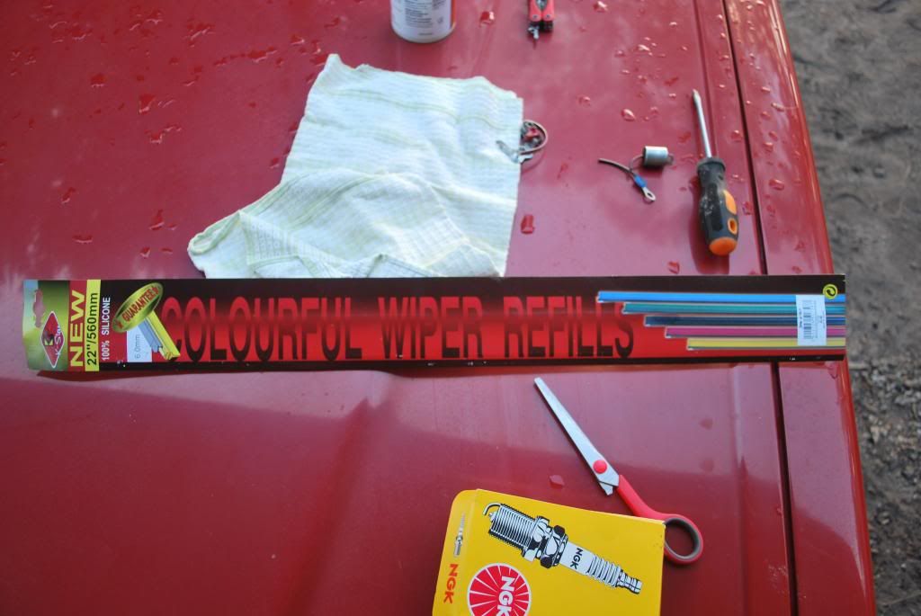

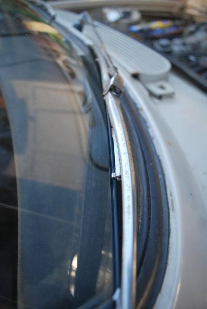

next up, wipers. the rubbers were shithouse:
new $2 specials....
fitted. can see shit now:

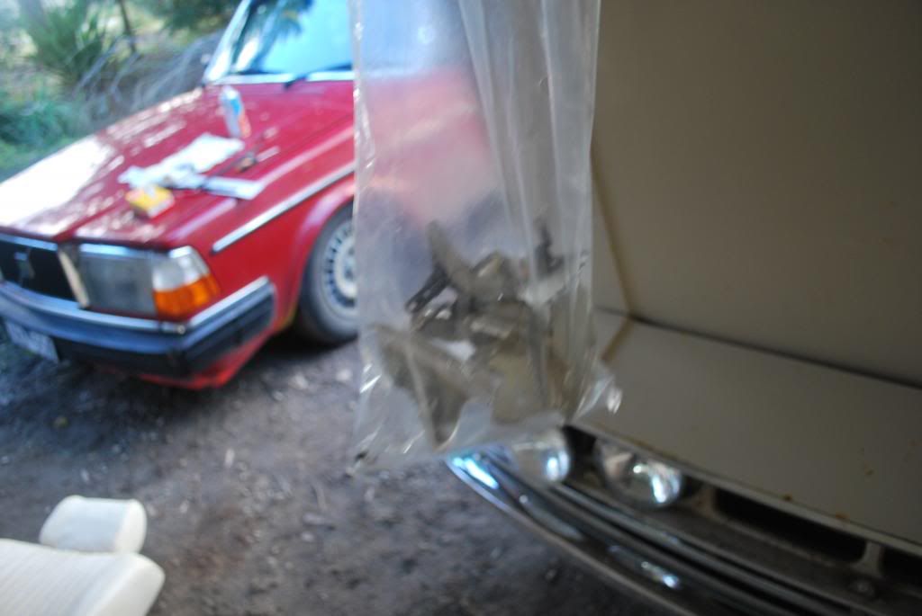

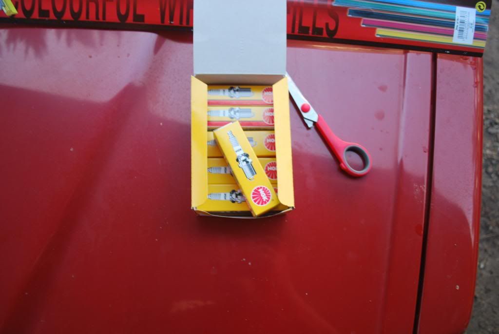

then fitted 6 of these:
number 2 wasnt even tight, butall are a lush biscuit colour...

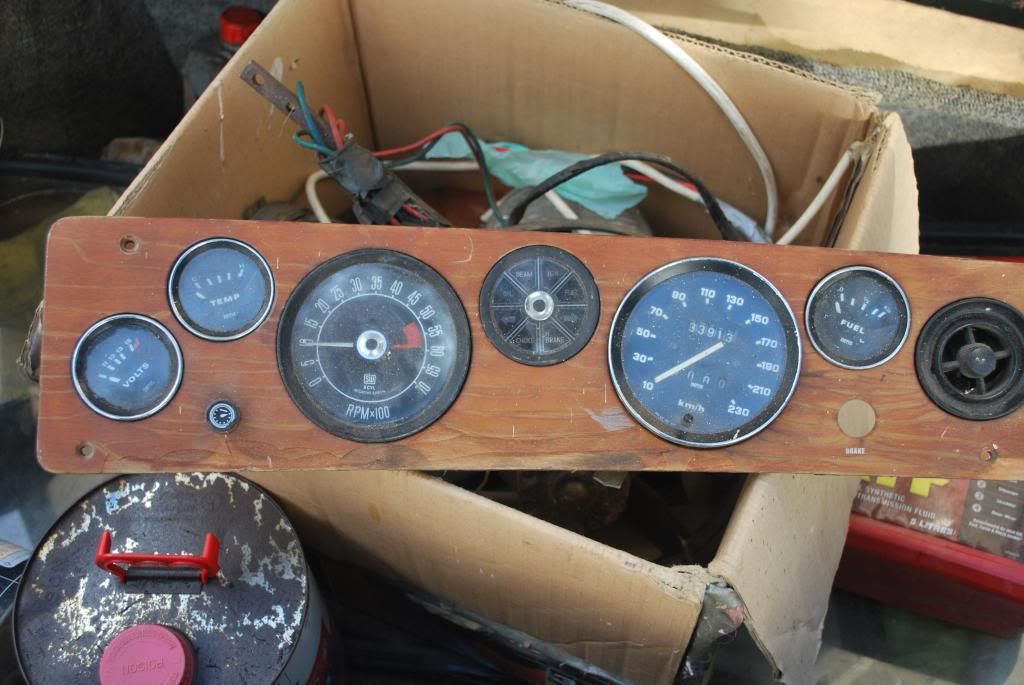

in the spares box, a nice 2500 injection dash;
that will be fitted after the wood gets re-laquered. on that subject:
