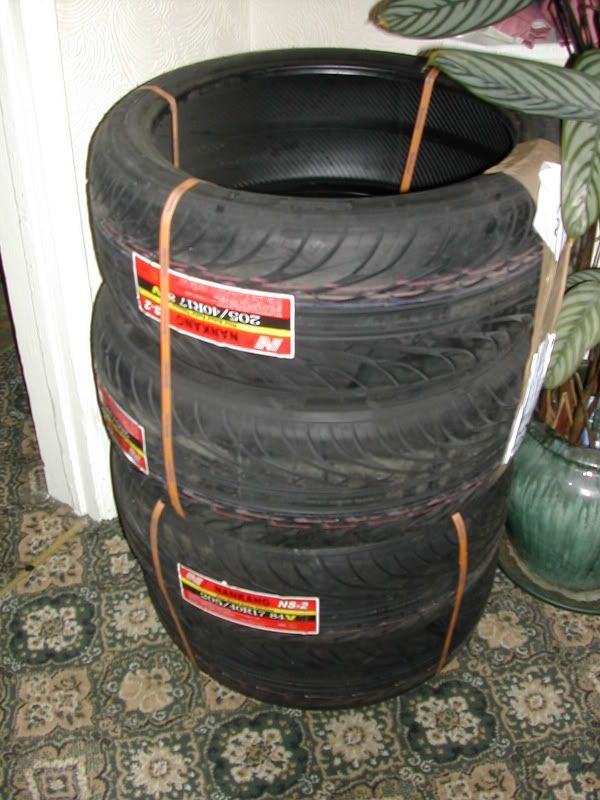

New tyres arrived last night (bargin, £150 new from ebay ;))

oohhh nankang tyres, wouldnt be putting them on if you want to be able to go round corners, especially in the wet:laugh:

the nankangs should be ok for standard road use, just dont try taking corners too quickly, and next time, save your pennies and buy some good rubber.
never ever ever ever ever ever ever underestimate the importance of having good tyres, and when i say good, i mean a reputable brand/tyre, not the amount of tread on the tyre, the boy that bought my corsa crashed it due to the fact that the front tyres were utter sh!t, brand new tyres, but he may as well have been running slicks because the tyres were absoltuely shocking, just slides all over the place
http://www.epinions.com/Nankang_NS_1_Radial_Passenger_Performance_Tire/display_~reviews
Just been reading some reviews and i think your maybe a "brand name" person that follows fashion :p
The only bad reviews were HIGH powered car owners that really shouldnt be looking at budget tyres anyway. And a guy complaining about their performance on cornering that drives a VAN!
All in quite good reviews ;)
And these tyres were Nankang?
Laura I have budget tyres and they're rubbish. They're ok for dry normal use but it can be a tad scary in the wet. When I bought my cars it had some well named tyres on (can't remember what), they were bald and the car cornered really well. Only lasted an hour though then the rear tyre popped lol.

so you and mark have opinions on them...is this based on your own use of them?
yes, and also others.
theyre certainly not the worlds worst budget tyre, but i was just making a point.
and the case i referred to, those were not nankangs, some other budget tyre.
as long as they feel ok when ur driving then thats the main thing :)
