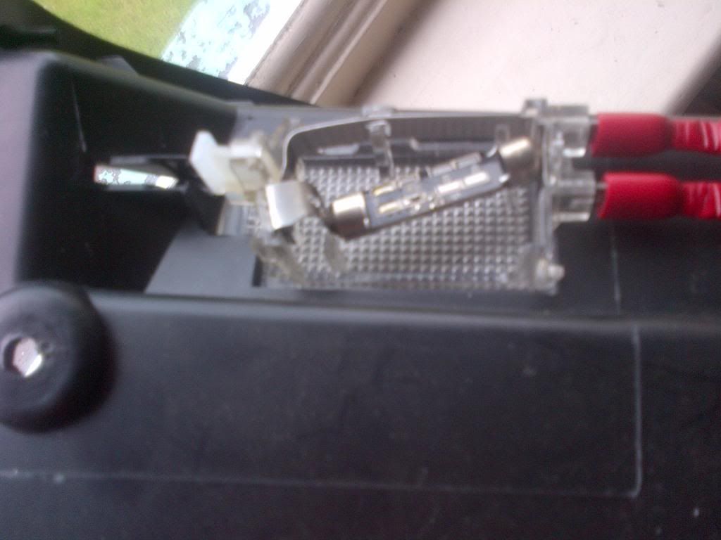

Trying to fit glovebox light to Corsa B, managed to get the light assy from scrapyard few months ago ( not sure if was from Astra or Vectra )
But, Fitted it today and blatently theres another bit I need to make it work on the Corsa Glovebox.
Any ideas ? or possibly pictures
Ta

I can't see what's missing? The item isn't in focus?

Sorry Vegas, Crap phone....
Can you see the hole in front of the white plastic bit
THe White Plastic bit pushes on the blade inside the asy making it go open circuit
Somethings gotta go in the hole
Al
When they touch the light goes off not comes on.
382 Posts
I never said the light came on, it will be on until the blades go open circuit !
But something has to push against the white bit to cause this to happen - What I needed to know was what ?
I take it from your replies you don't know !
9,910 Posts
I had the same problem when i tried to fit one in mines.
IIRC if you want to use the glove box light, you need the glove box that already has a light in it as well as they have the piece of plastic that you're looking for.
Only the older Corsa's with the grey dash had this as standard from when i've been looking in scrapyards, and Tigras have it as well with the black dash.
