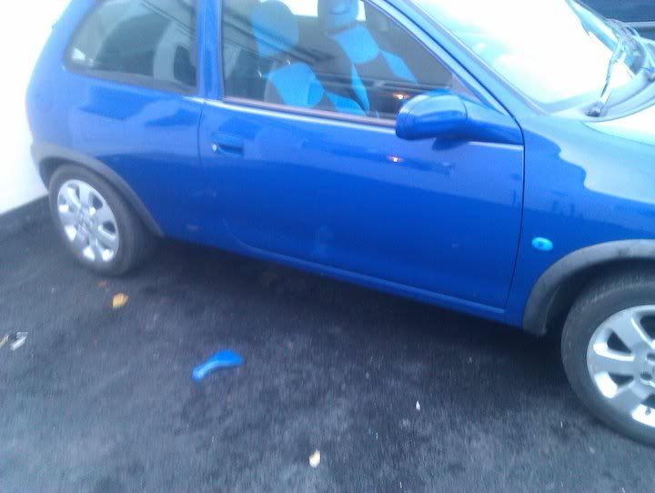

hi guys today i de bumpstriped my car using a slightly different method to everyone else so thought id share, by the way this is my first tutorialt

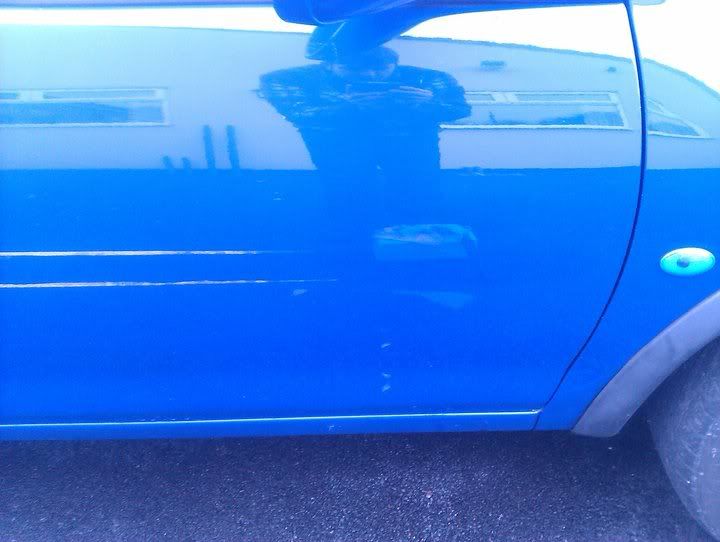

while still hot slide top up card/ ice scraper etc underneath it and using a sawing action cut through the adhesive

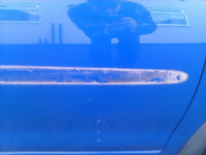

then you will be left with this
clean up the area with warm soapy water then dry thoroughly

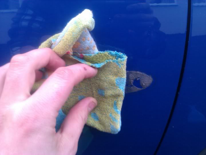

soak a rag with petrol and rub onto the adhesive left on the door making sure it soaks in

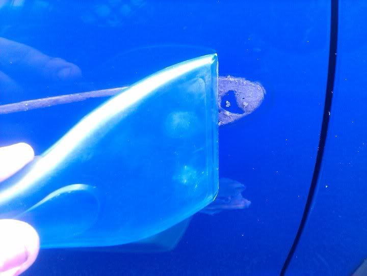

then gentley start scraping the adhesive off in smooth one stroke motions
keep using the petrol rag between scrapes, as the petrol dissolves the adhesive and also lubricates the area stopping it all sticking back on
after 5 minutes you should have got this far
then after 20 or so minutes
that one side done
