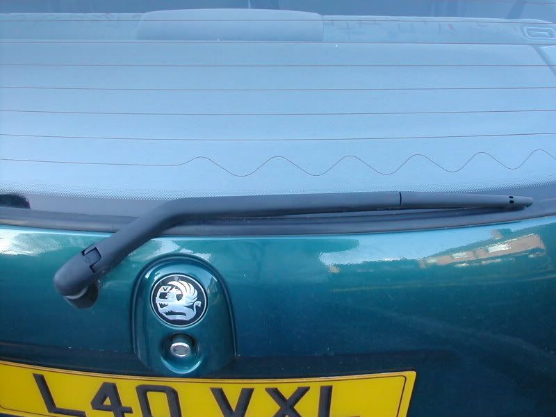

This has got to be the shortest how 2 ever so ive taken lots of pics to bump it out a bit :laugh:

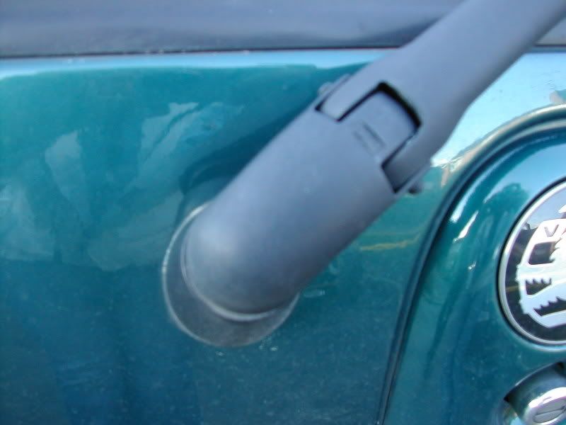

Firstly Lift the cap that sits over the nut that nuts it to the car

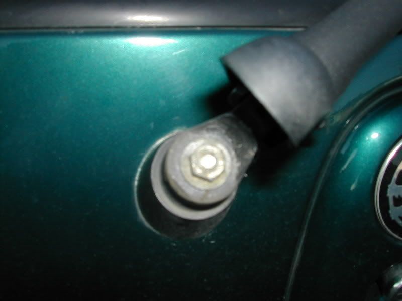

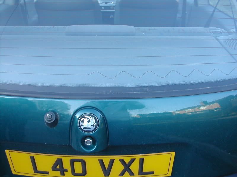

Remove the 10mm nut and the wiper arm comes off (with a wiggle)

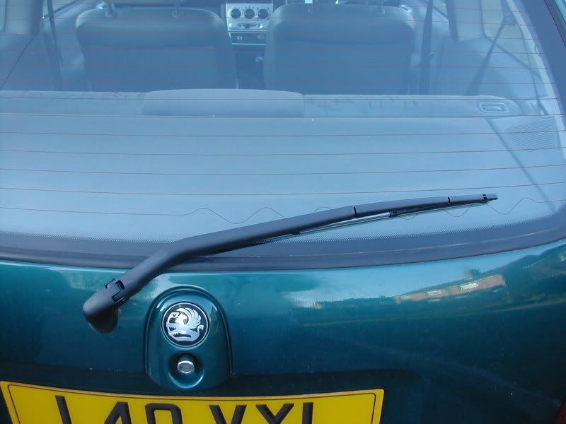

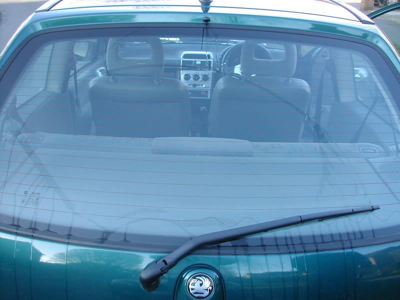

Now put the new one on making sure you line in up to the window edge and replace nut
You can just see the clearing circle on this pic and it is about an inch wider. Defintly better for visablity but doesnt sit as flush
Good little guide, sure it will come in handy soon, but i dont have a cap over the nut on my wiper:(
Thats cos Laura's previous wiper was a Punto one. On the original corsa one there is no cover you just undo the nut :thumbs_up:
