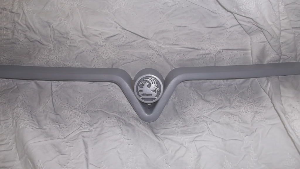

Step 5:
Now the fun starts
take your (pre-warmed in warm water) primer, give it a good shake and proceed to give a nice light coating on the parts, no need for a heavy coat at the moment, just a light base:

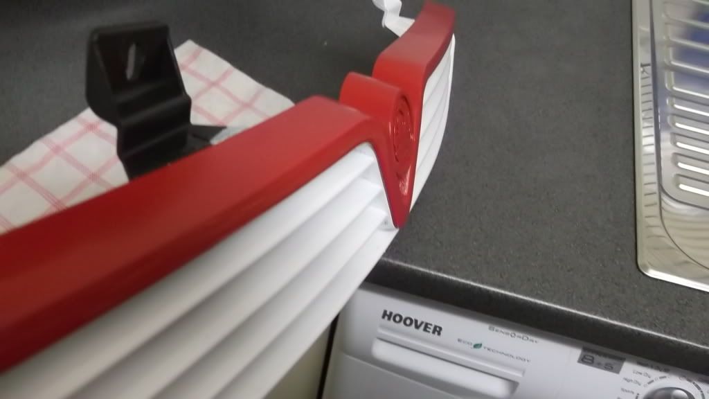

So after the plastic is dry, you'll want to start adding your chosen colours, my colour scheme is red and white (for the minute). As with the primer, do a light base coat, second coat around 10 mins after and then progressive coats around 20-30 mins apart (on both primer and colour I do 4-5 coats of each). Patience is the key here, I know you hear it everywhere but it's better to do 4-5 light coats spaced further apart than 2-3 heavy coats in a short space of time as you will get runs, patches and the overall finish will be disappointing. However, I've found the HYCOTE paints to be quite good on drying times which helps speed the process slightly. use your common sense when judging the rate at which you work :thumbs_up: :
Step 9:
So once you're happy with the finish, allow the paint to harden until the next day (in this instance the paint only hardened for around 6 hours, but I would always advise as long as possible).
Step 10:
Next comes the lacquer. The same applies as the previous steps. A light base coat for the second coat to adhere to. Then progressive coats every 30 mins. Make sure coats are very light (but even) as lacquer is more prone to run than paint. This is the last step in terms of painting so take your time and do it right so you only have to do it once, you don't want all your previous work un-done by rushing
So if you've followed these steps you should end up with something along the lines of:

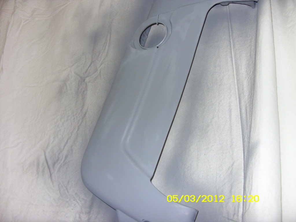

Step 2:
Lightly sand the surface to key it and give the primer a good surface to adhere to:
Step 3:
Lightly do the base coat of primer and gradually build up the coats every 20 mins or so:
