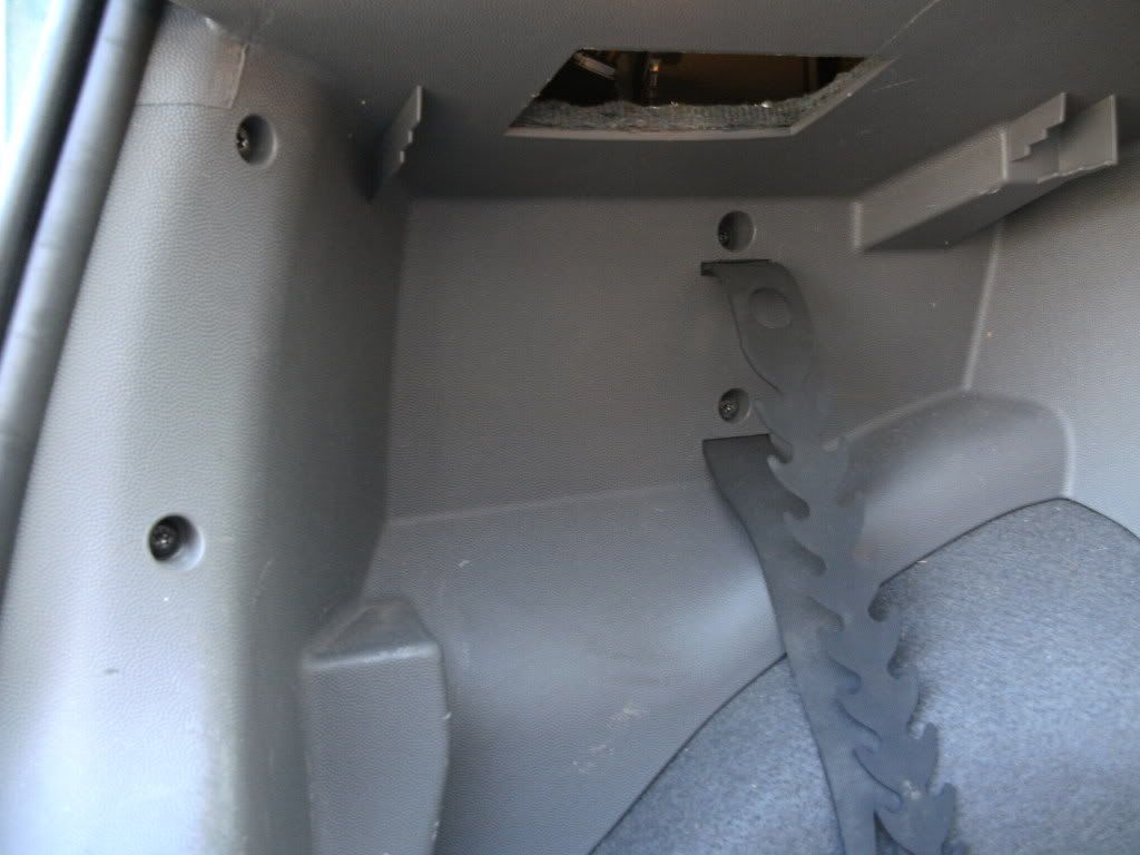

Here you can see a very messy boot and on the left the rear trim. Push your seats forwards like mine to make more room for yourself. I suggest you remove your boot light now, you will need to take it out anyway and you might get a nasty burn like me otherwise:p

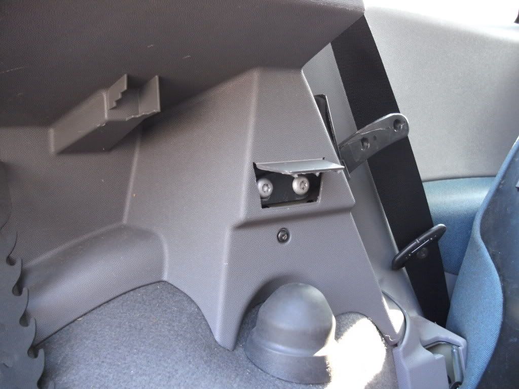

Open the flap which houses the bracket for the rear seats and attach your T40 bit to your screwdriver, screw both of these out and put the bracket and the screws to one side

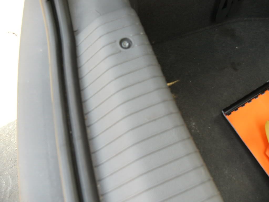

Remove the 4 torx screws here with your T25 bit.

Next I remove the trim at the bottom here. Again use your T25 bit and put to oneside.

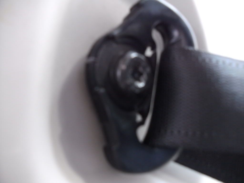

Get your ratchet (Or if you have a screwdriver what can hold the T50 bit) and put on the T50 bit. Take out the seatbelt bolt and push the bracket down to the end of the belt.

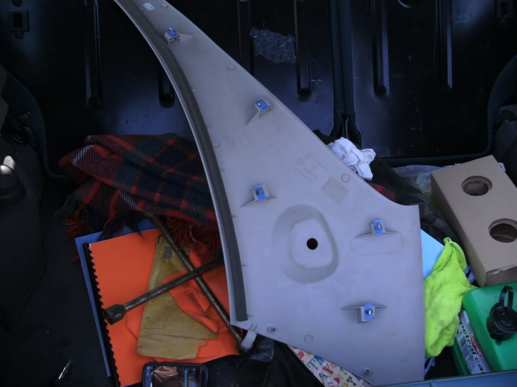

Pull back the rubber strips and then begin to carefully pull out the interior trim. All you're doing here is pulling the clips out from the body, they make some noise, don't worry just be gentle ;). Place it to oneside and put on any broken clips now for late.
Picture of out trim:

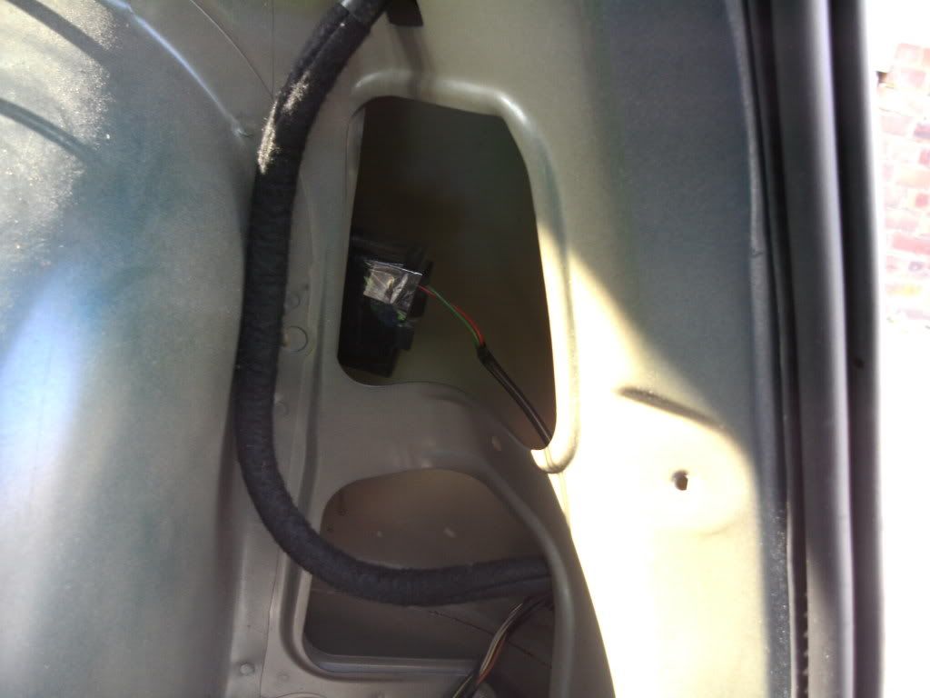

If you take off the otherside (same process, no boot light though) you can access the petrol flap servo if it has fallen.
Petrol servo location:
