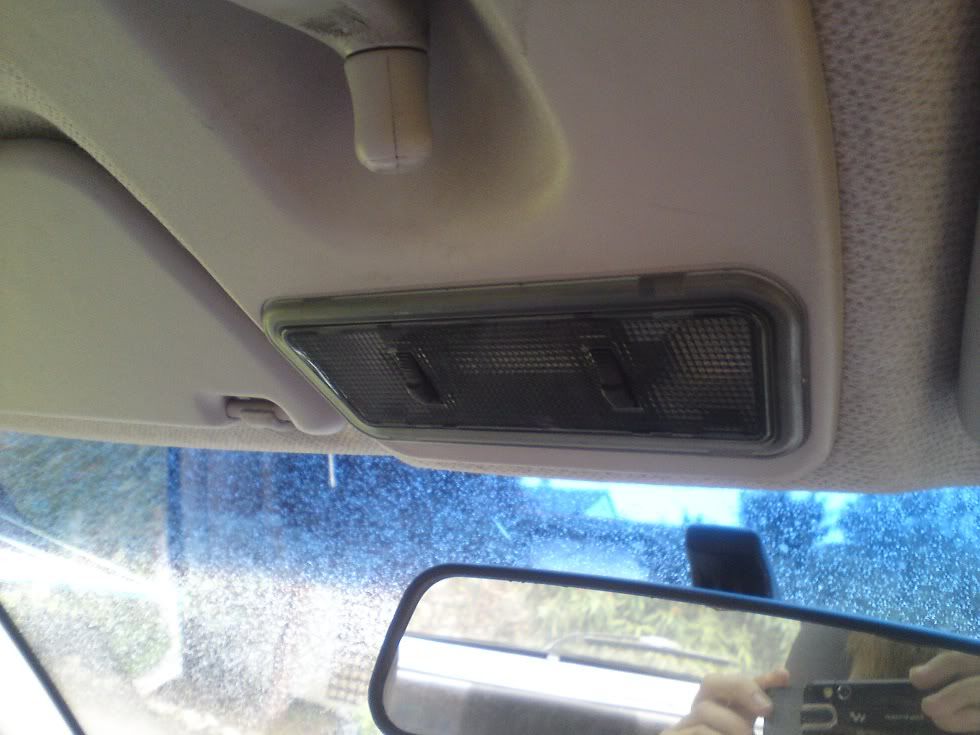

STEP 1
Get yourself a Vectra B smoked interior map light :)

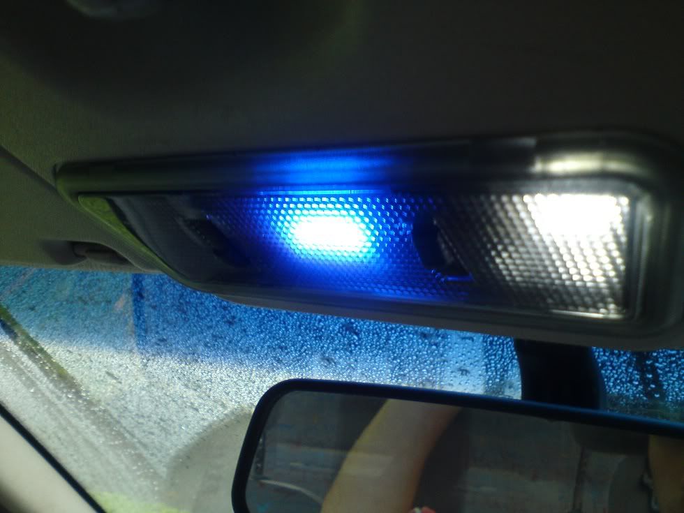

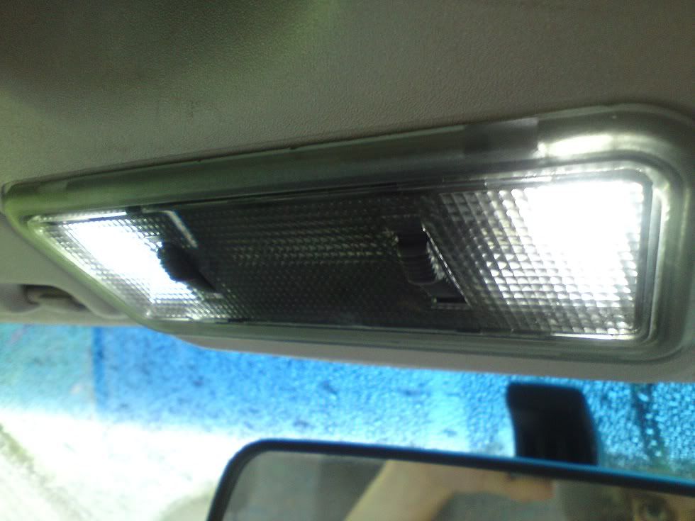

RESULT
The interior light should work just as it did before in your Corsa but both of the side map lights will work completely indepedently even when the ignition isn't even turned on :)

The middle light is a blue 6 LED 42mm festoon bulb and the side lights are white LED 501 W5W bulbs :thumbs_up:
