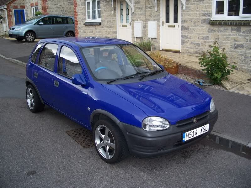

Ok here is a picture of my car looking nice and clean for once!
Thats the first time its been cleaned for three months, would have taken more pictures but my cameras battery went flat :(

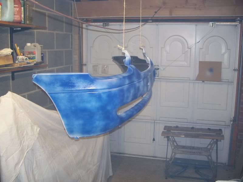

Here is whats in my garage at the moment, thought i might as well have a quick go at it as i had some spare time on my hands.
Looks like you cleaned that well, needs lowering though. Will look good once that post-97 bumper is on.
Yeah i will lower it soon, pay day on friday so we shall see how my money situation is.
Ive got the post 97 front bumper to put on and a rear aswell so once all done should be great
Is that sprayed? Or have yo been sanding it
That was a textured bumper that i sanded smooth, primed and thats a picture of the first colour coat
Best way mate - light coatings and build it up :thumbs_up:
Yeah its had three coats so far and is looking ok, another couple and it should be ready for a light sanding down and lacquering.
I always get worried i will screw up the lacquering, im self taught so am always worried im not doing it right :(
As long as you remember to warm can up before spraying you'll be fine mate :thumbs_up:

Yeah if that's a first coat it looks very patchy, all my coats fully covered the primer. 1 can to each coat on my front bumper. It is costly but other people geebs and kingsizeriz use hycote products / paints which are a bit cheaper than halfords stuff. I think hycote ones are a better colour match as well as I think my paint work will need a bit of a tcut or polishing to get it to match
Yeah that was a very quick first coat just to get it started, after three coats its pretty much done, just need to recover some patches and get it all perfect :)
