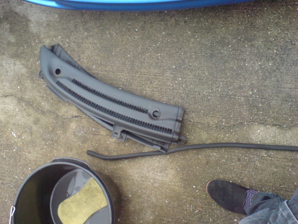

So from the beginning i took off my windscreen wipes and scuttle panel
This is what i found under the scuttle panel

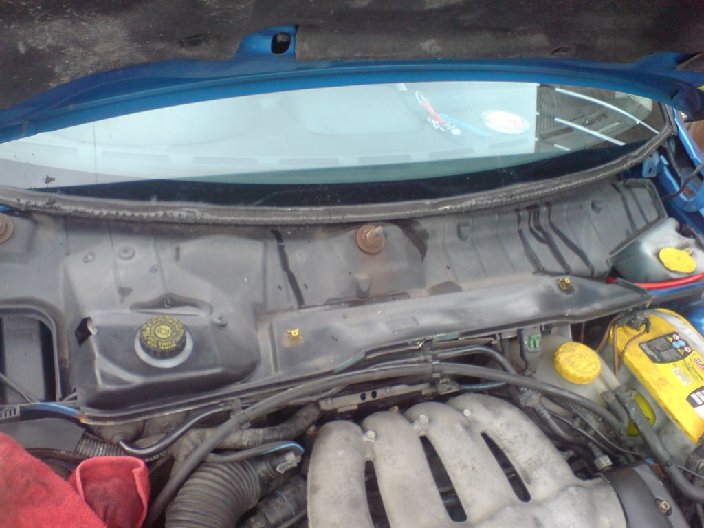

Then took the other plastic part off thats under the panel
Then under that one i found muck everywhere

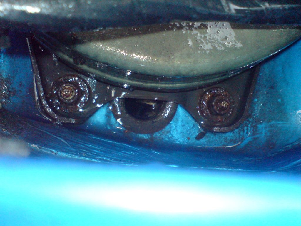

This is full of dirty black water around my brake master cylinder
So i started removing bits and bobs like my windscreen wash bottle, alarm horns and fuse box so i could get underneath.
I cleaned around in use one of my tatty microfibre cloths and unblocked the drain holes with a flat headed screw driver.
After i sprayed it out with hose pipe i gave it a wipe over and found nice blue bodywork (If this rusts through you will get water entering under the brake master cylinder and you will have a wet drivers foot-well)
